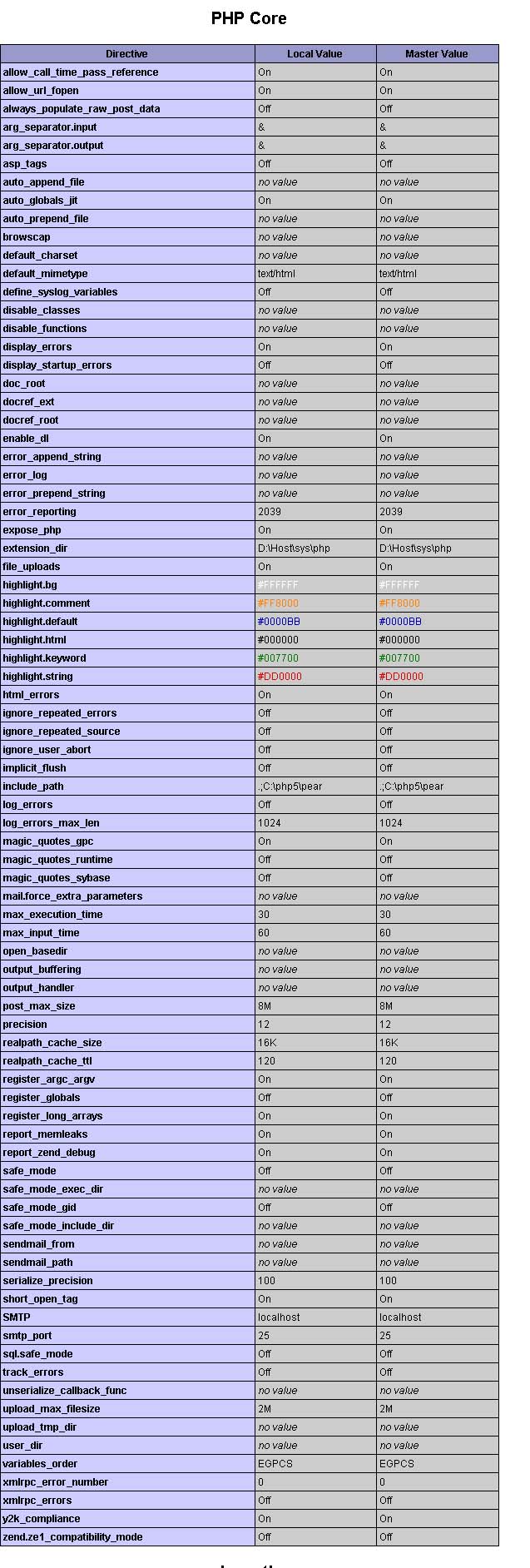

发个phpinfo.php看看
 楼主| 路乙 发表于 2009-6-21 15:06:24 | 显示全部楼层
传上来了!!!!!!!!!!!!!!!!!!!!!!!!!!!!!!!!!!!!!!
