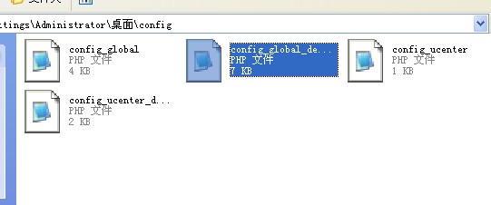

0777 发表于 2011-10-10 15:53:56 | 显示全部楼层 |阅读模式
上图说明:没有修改那个config里面的文件是这样,如下图:
修改了下图其中有蓝色阴影的文件,照样是跟第一个图那样,看其他几个文件,似乎没有修改的地方吧?麻烦官方说清楚一些,比较大家都不是很专业人士,如果搞到做一个论坛,非要会自己写,会自己看懂大部分源码的话,人家还不如自己写一个呢?

 楼主| 0777 发表于 2011-10-10 15:55:49 | 显示全部楼层
jj就该了其中三处地方
// ----------------------------  数据库相关设置---------------------------- //
* 数据库主服务器设置, 支持多组服务器设置, 当设置多组服务器时, 则会根据分布式策略使用某个服务器
* @example
* $_config['db']['1']['dbhost'] = 'localhost'; // 服务器地址
* $_config['db']['1']['dbuser'] = 'a1008150331'; // 用户
* $_config['db']['1']['dbpw'] = '17749714';// 密码
* $_config['db']['1']['dbcharset'] = 'gbk';// 字符集
* $_config['db']['1']['pconnect'] = '0';// 是否持续连接
* $_config['db']['1']['dbname'] = 'x1';// 数据库
* $_config['db']['1']['tablepre'] = 'pre_';// 表名前缀
* $_config['db']['2']['dbhost'] = 'localhost';
$_config['db'][1]['dbhost']                  = 'localhost';
$_config['db'][1]['dbuser']                  = 'a1008150331';
$_config['db'][1]['dbpw']                  = '17749714';
$_config['db'][1]['dbcharset']                 = 'gbk';
$_config['db'][1]['pconnect']                 = 0;
$_config['db'][1]['dbname']                  = 'ultrax';
$_config['db'][1]['tablepre']                 = 'pre_';
* 数据库从服务器设置( slave, 只读 ), 支持多组服务器设置, 当设置多组服务器时, 系统每次随机使用
* @example
* $_config['db']['slave']['1']['dbhost'] = 'localhost';
* $_config['db']['slave']['1']['dbuser'] = 'a1008150331';
* $_config['db']['slave']['1']['dbpw'] = '17749714';
* $_config['db']['slave']['1']['dbcharset'] = 'gbk';
* $_config['db']['slave']['1']['pconnect'] = '0';
* $_config['db']['slave']['1']['dbname'] = 'x1';
* $_config['db']['slave']['1']['tablepre'] = 'pre_';
* $_config['db']['slave']['2']['dbhost'] = 'localhost';

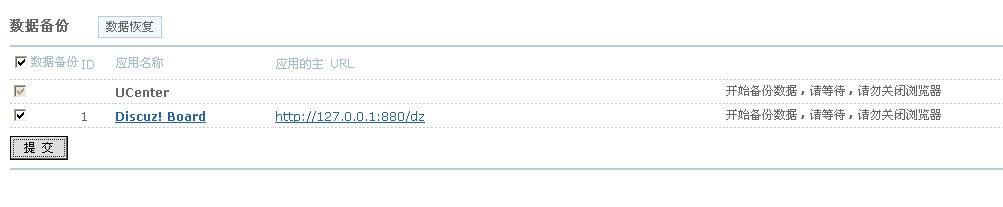

 楼主| 0777 发表于 2011-10-11 01:02:39 | 显示全部楼层
操作之后就是这样的结果。。。
Discuz! Database Error
The database has encountered a problem. Need Help?
Error messages:
[Type] 无法连接到数据库服务器
[1045] Access denied for user 'root'@'localhost' (using password: YES)
Program messages:
[Line: 0051]forum.php(discuz_core->init)
[Line: 0065]source\class\class_core.php(discuz_core->_init_db)
[Line: 0356]source\class\class_core.php(db_mysql->connect)
[Line: 0756]source\class\class_core.php(db_mysql->_dbconnect)

IDC866.com 发表于 2011-10-15 10:35:33 | 显示全部楼层
楼主,你这是在自己电脑上  玩论坛吗?
怎么UC里的应用为  127.0.0.1 呢
还有,看你   UC配制文件里:
这应该是国内那些  星外  主机空间管理系统  的数据库信息。  也就是说,你这应该是在空间,不是在自己电脑上吧(除非是你自己在电脑上 新建了一样的数据库信息)
如果应用地址不正确,那通讯是不正常的,不正常就无法备份论坛数据的。
推荐楼主  去下载一个帝国备份王   备份、恢复 MYSQL 数据 简单、稳定、安全。
