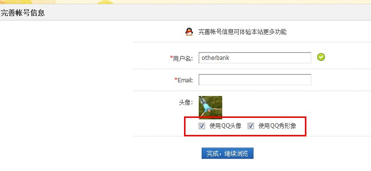

问题介绍:
Discuz! X2.5的QQ注册完善用户信息时默认是显示勾选“使用QQ头像”和“使用QQ秀形象”,后台并没有取消默认勾选的功能,如果站长想要取消默认勾选,可以按照下面的方法修改
解决方法:
找到文件"\source\plugin\qqconnect\template\module.htm"497到513行代码:
  1. <!--{if $connect_app_id && $connect_openid}-->
  2.         <div class="rfm">
  3.                 <table>
  4.                         <tr>
  5.                                 <th>{lang qqconnect:connect_register_avatar}:</th>
  6.                                 <td>
  7.                                         <img src="{$_G[connect][avatar_url]}/$connect_app_id/$connect_openid" width="48" height="48" />
  8.                                         <p>
  9.                                                 <label for="use_qzone_avatar"><input type="checkbox" name="use_qzone_avatar" id="use_qzone_avatar" class="pc" value="1" checked="checked" tabindex="1" /> {lang qqconnect:connect_register_use_qzone_avatar}</label>
  10.
  11.                                                 <label for="use_qqshow"><input type="checkbox" name="use_qqshow" id="use_qqshow" class="pc" value="1" checked="checked" tabindex="1" /> {lang qqconnect:connect_register_use_qqshow}</label>
  12.                                         </p>
  13.                                 </td>
  14.                         </tr>
  15.                 </table>
  16.         </div>
  17.         <!--{/if}-->
修改为:
  3.                 <table>
  4.                         <tr>
  6.                                 <td>
  8.                                         <p>
  9.                                                 <label for="use_qzone_avatar"><input type="checkbox" name="use_qzone_avatar" id="use_qzone_avatar" class="pc" value=""  tabindex="1" /> {lang qqconnect:connect_register_use_qzone_avatar}</label>
  10.
  11.                                                 <label for="use_qqshow"><input type="checkbox" name="use_qqshow" id="use_qqshow" class="pc" value=""  tabindex="1" /> {lang qqconnect:connect_register_use_qqshow}</label>
  12.                                         </p>
  13.                                 </td>
  14.                         </tr>
  15.                 </table>
  16.         </div>
  17.         <!--{/if}-->
OK
