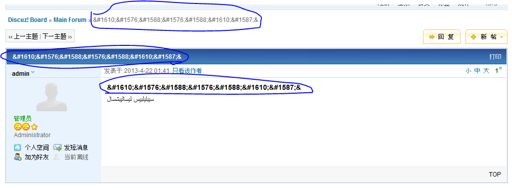

 楼主| Dr.AM 发表于 2013-4-24 16:30:41 | 显示全部楼层
Converted successfully to discuz 6.0 but there is a problem
the arabic thread name came like this !? Why ?
it is must be بسم الله not like the image !?
baxter 发表于 2013-4-24 16:38:59 | 显示全部楼层
修改一下原程序,过滤一下字符和代码
