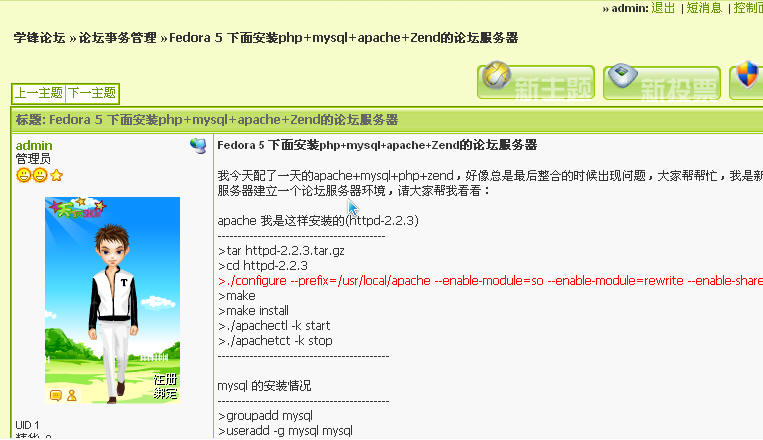

我今天配了一天的apache+mysql+php+zend,好像总是最后整合的时候出现问题,大家帮帮忙,我是新手,不是很会,我主要是想用自己的服务器建立一个论坛服务器环境,请大家帮我看看:
apache 我是这样安装的(httpd-2.2.3)
>tar httpd-2.2.3.tar.gz
>cd httpd-2.2.3
>./configure --prefix=/usr/local/apache --enable-module=so --enable-module=rewrite --enable-shared=max
>make
>make install
>./apachectl -k start
>./apachetct -k stop
mysql 的安装情况
>groupadd mysql
>useradd -g mysql mysql
>tar -xzvf mysql-5.0.22.tar.gz
>ls
>cd mysql-5.0.22
>./configure --prefix=/usr/local/mysql
>make
>make install
>cp support-files/my-medium.conf /etc/my.conf
>cd /usr/local/mysql/bin
>./mysqld_safe_db --user=mysql
>chown -R root:mysql  /usr/local/mysql
>chown -R mysql:mysql /usr/local/mysql/var
>./mysqld_safe --user=mysql & //启动mysql服务器
>./mysqladmin -u root password 72805863 //修改mysql的密码设置
php 我是这样安装的
>tar -xzvf php-5.1.4
>cd php-5.1.4
>./configure --prefix=/usr/local/php --with-apxs2=/usr/local/apache/bin/apxs \
                                                        --with-mysql=/usr/local/mysql \
                                                        --with-libxml \
                                                        --with-gd \
                                                        --with-jpeg \
                                                        --with-zlib \
                                                        --with-freetype
>make
>make install
>cp phph.ini-dist /usr/local/php/lib/php.ini
修改php.ini
register_globals=on
找到
AddType application/x-compress .Z
AddType application/x-gzip .gz .tgz
在下面添加:
AddType application/x-httpd-php .php
AddType application/x-httpd-php-source .phps
重启apache
./apachectl restart
结果出现:
[root@localhost php-5.1.4]# cp php.ini-dist /usr/local/php/lib/php.ini
[root@localhost php-5.1.4]# cd /
[root@localhost /]# cd /usr/local/apache/bin
[root@localhost bin]# ls -a
.   ab         apr-1-config  apxs      dbmmanage  envvars-std   htdbm     htpasswd  httxt2dbm   rotatelogs
..  apachectl  apu-1-config  checkgid  envvars    htcacheclean  htdigest  httpd     logresolve
[root@localhost bin]# ./apachectl -k restart
httpd: Syntax error on line 53 of /usr/local/apache/conf/httpd.conf: Cannot load /usr/local/apache/modules/libphp5.so into server: /usr/local/apache/modules/libphp5.so: cannot restore segment prot after reloc: Permission denied
好像是说php相关模块没有加载,怎么样才能够加载好,非常谢谢你们!  QQ:258136631
