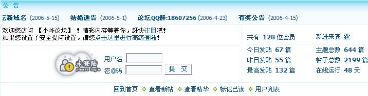

应该这样才对,
而不是改对应模板!!!
修改index.htm的时候要这个!!才对
<div class="maintable">
<table cellspacing="{INNERBORDERWIDTH}" cellpadding="{TABLESPACE}" width="{TABLEWIDTH}" align="center" class="tableborder">
<tr><td colspan="3" class="header"><a href="###" onclick="toggle_collapse('forumlinks');"><img src="{IMGDIR}/collapsed_no.gif" align="right" border="0">        </a>
                <span class="bold">公    告</span></td></tr>
                <tbody id="forumlinks" style="$collapse[forumlinks]">
                <tr class="category">
                        <td colspan="3" align="center">
<!--{if empty($announcements)}-->
                {lang index_noannouncement}
        <!--{else}-->
                <marquee direction="left" scrollamount="3" onMouseOver="this.stop();" onMouseOut="this.start();">
                $announcements
                </marquee>
        <!--{/if}-->
        </td></tr>
<!-- aaaaaa -->
<tr><td class="altbg2" onMouseOver="this.className='altbg1'" onMouseOut="this.className='altbg2'">
<!--{if $discuz_uid}-->
<TABLE width="98%" align=center border=0>
<font face=Wingdings  color=#5CA408>v</font> {lang credits}: <span class="bold">$credits</span>
<!--{loop $extcredits $id $credit}-->
        $credit[title]: <span class="bold">$GLOBALS[extcredits.$id]</span>$credit[unit]
<!--{/loop}-->
/ {lang index_status}:
<!--{if $validdays}--><a href="member.php?action=groupexpiry"><span class="bold">$grouptitle</span>($validdays)</a><!--{else}--><span class="bold">$grouptitle</span><!--{/if}-->
<!--{if !empty($invisible)}--> / {lang login_invisible_mode}<!--{/if}-->
              <TBODY>
              <TR>
                <TD align=middle width=88 rowSpan=6><A href="memcp.php?action=profile" border="0" height="90" title="如果您想更新个性头像请点击这里" align="absmiddle">$avatar</A></TD>
              <TR>
                <TD height=22> :: <A
                  href="memcp.php">
                我的个人控制面板</A></TD>
                <TD colSpan=2> :: <A
                  href="stats.php">我的论坛排名</A>
                </TD></TR>
              <TR>
                <TD bgColor="{INNERBORDERCOLOR}" colSpan=3 height=1></TD></TR>
              <TR>
                <TD> :: <A class=table
                  href="search.php?authorid=3">我发表的主题</A>
                </TD>
                <TD> :: <A
                  href="pm.php?action=send">发送论坛短信</A>
                </TD></TR>
              <TR>
                <TD> :: <A
                  href="memcp.php?action=buddylist">我的论坛好友</A>
                </TD>
                <TD> :: <A
                  href="member.php?action=list">我的会员中心</A>
                </TD></TR>
              <TR>
                <TD> :: <A
                  href="pm.php?folder=inbox">查看我的信件</A>
                </TD>
                <TD> :: <A
                  href="memcp.php?action=favorites">我的论坛收藏</A>
                </TD></TR></TBODY></TABLE></TD>
<!--{else}-->
<font color=black>欢迎您访问 【小岞论坛】 !精彩内容等着你,赶快<a href="register.php">注册</a>吧!<br>
如果您设置了安全提问设置,请您<a href="logging.php?action=login">点击这里进行高级登陆</a>!</font>
<hr width="100%" style="height: 1px; color: {INNERBORDERCOLOR}">
<table border=0 cellpadding=0 cellspacing=0  align="center">
<form method="post" action="logging.php?action=login">
<tr><td>
<img src="images/logining.gif" border=0 align="left" width="100" height="58" title="登陆后更精彩">
</tr>
<td>
{lang username} <input type="text" name="username" size="10" tabindex="1"><BR>
密@码 <input type="password" name="password" size="10" tabindex="2">
   <input type="submit" name="loginsubmit" value="{lang submit}">
                 </td>
              </form>
            </table>
<!--{/if}-->
  <td valign="middle" bgcolor=#FFFFFF  onMouseOver=this.style.backgroundColor='#F7F8F8' onMouseOut=this.style.backgroundColor='#FFFFFF' ><TABLE border=0 width="98%" align=center>
    <tr>
       <td height=22>共有 <span class="bold">$totalmembers</span> {lang index_members} </td>
      <td>新进来宾 <a href="viewpro.php?username=$memberenc"><span class="bold">$lastmember</span></a></td>
        </tr>
        <tr>
          <td height="1" bgcolor="{INNERBORDERCOLOR}" colspan="2"></td>
        </tr>
        <TR>
      <TD>今日发贴 <span class="bold">$todayposts</span> 篇</td>
      <TD>主题总数 <span class="bold">$threads</span> 篇</td>
    </tr>
    <tr>
      <td>昨日发贴 <span class="bold">$yesterdaynum</span> 篇</td>
      <td>帖子总数 <span class="bold">$posts</span> 篇</td>
    </tr>
<tr><td>最高发贴 <span class="bold">$maxnum</span> 篇</td>
    <td>在线运行 <span class="bold">$build_days</span> 天</td>
        </tr>
  </table></td>
  <td bgcolor=#FFFFFF valign="middle">
<DIV ALIGN="CENTER">
        <OBJECT  CLASSID="clsid:D27CDB6E-AE6D-11cf-96B8-444553540000"
CODEBASE="http://download.macromedia.com/pub/shockwave/c abs/flash/swflash.cab#version=5,0,0,0" WIDTH="110"  HEIGHT="105">
<PARAM NAME=movie VALUE="images/Clock.swf">  <PARAM NAME=quality VALUE=high><PARAM NAME="wmode"  VALUE="transparent">
<EMBED SRC="images/Clock.swf" QUALITY=high
PLUGINSPAGE="http://www.macromedia.com/shockwave/downloa d/index.cgi?P1_Prod_Version=ShockwaveFlash"
TYPE="application/x-shockwave-flash" WIDTH="100"  HEIGHT="100" WMODE="transparent"></EMBED>
</OBJECT> </DIV>
</td>
<tr><td bgcolor=#FFFFFF align="center"  colspan="2" height="25" width="80%">
                <a href="index.php">回到首页</a> <font face=Wingdings  color=#5CA408>v</font><a href="search.php?srchfrom=$newthreads&searchsubmit=yes"> {lang show_newthreads}</a> <font face=Wingdings  color=#5CA408>v</font>
        <a href="search.php?srchuid=$discuz_uid&mytopics=yes&searchsubmit=yes">{lang show_mytopics}</a> <font face=Wingdings  color=#5CA408>v</font>
        <!--{if $allowuseblog}-->
                <a href="blog.php?uid=$discuz_uid" target="_blank">{lang blog}</a> <font face=Wingdings  color=#5CA408>v</font>
        <!--{/if}-->
<!--{/if}-->
<a href="digest.php">查看精华</a> <font  face=Wingdings color=#5CA408>v</font>
<a href="member.php?action=markread">{lang mark_read}</a> <font face=Wingdings  color=#5CA408>v</font>
<a href="member.php?action=list">用户列表</a></td>
<td bgcolor=#FFFFFF width="17%" height="20"><table cellspacing=1 cellpadding=1 style="font-family: Tahoma, Verdana;BORDER: #8C8E7B 1px solid;background:#FFFFFF;" align="center">               <td style="background:#FF6500;font-size: 7pt;color:#ffffff;" valign="top"> XML </td>
<td style="background:#8C8E7B;font-size: 7pt;" valign="top"> <a href="rss.php" target="_blank" title="订阅本版面最新帖子"><font color='#ffffff'>RSS 2.0</font></a> </td>
<td style="background:#8C8E7B;font-size: 7pt;"> <a href="faq.php?faqjob=2#5" target="_blank" title="通过手机访问论坛"><font color='#ffffff'>WAP</font></a> </td>
</table>
</table><br></div>
演示论坛http://www.xiaozuo.com/bbs
